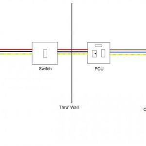

    Are there rules on placement of switch for combi boiler?
    I've attached a crude diagram to help try and explain what I'm talking about and I can get pictures if anybody wants further clarification. Simply put, the supply cable for my combi boiler runs to a very old looking switch inside the airing cupboard (which is also where the combi boiler...
