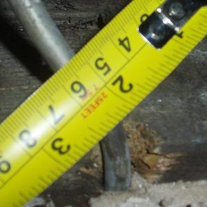

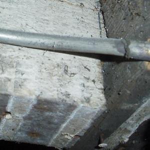

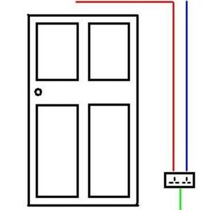

I'm about to embark on a project to pull down my existing lath and plaster ceiling and replace with plasterboard, prior to having it professionally skimmed.
I plan to use 12.5mm square edged boards, and would be grateful if anyone could advise on the following:
1) Should the...
