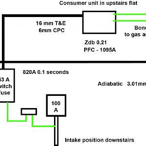

    OK thanks for the replies. Sorry if I am not using correct terms or being a bit to abbreviatory :) if such a word exists. So the gas pipe enters the flat at first floor level. Connected to that pipe via a BS 591 clamp is the 10mm2 main protective bonding conductor for the gas. That MPB...
  4. S
    MPB back to the MET or CU?
    This is not a real situation, but based on lots of flats I've seen. This is in London where you have many flats in one house. Pipe work is often not accessible in hallways. Often you can see the gas pipework external to the building and entering at the flat.
  5. S
    If you have a TNCS supply coming into the property In the down stairs meter cupboard you have a switch fuse protecting a 16mm2 T&E cable feeding a CU in an flat in the building. I was just doing some Adiabatic sums on the 6mm2 CPC in the T&E ( Theoretical only, this is not a real example) to...
