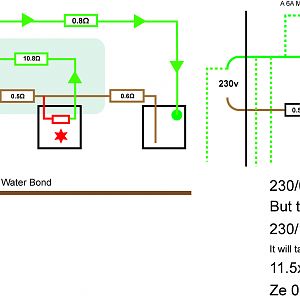

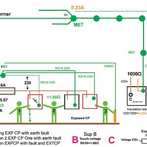

    TV3
  2. S
    Touch voltage
    Thanks so much for taking the time to explain. What I don't understand, 'Is does rise to above 50v'. But its at 230v - is not like you have a dial and slowly turning up the voltage. So its not about limiting the voltage its the time it takes. And to get a very quick trip , you need a very...

    I don't really understand touch voltage, I'm embarrassed to say... When I ask people they usually say , stop over thinking it , the RCD will take care of it.. Im not to keen on leaving everything to an RCD, Ive found a few that don't work as expected.. I know the principle. And exposed...

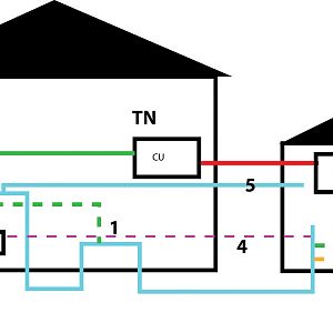

  12. S
    Extraneous conductive part
    Thanks EFLImpudence, really appreciate your help. There is something about MPB, which constantly make me unsure.
  13. S
    Am I getting this wrong EFLI you say the pipe in the second location should be MPB to the local earth bar (CU in second building)? But this pipe is already a protective bond between the two locations. Basically this pipe could be seen as a green and yellow conductor between the two buildings...

  15. S
    A metal water pipe enters the building , Its a Extraneous Conductive part (ECP) so needs Main protective bonding to the MET. That same pipe, has a branch off it which then goes back under the floor (buried) and re appears in another room in the same house. (1) Does the second appearance of the...
