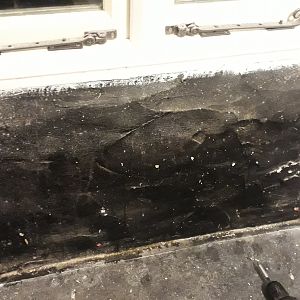

  6. A
    Matching new mortar (for re-pointing) to old
    Sorry for the delayed reply. It's stone (Blue Lias). The crack is almost entirely in the joints, though it does go through two stones. Thanks, Adam Here's piccy, in case it helps:
