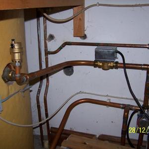

    Hot water cylinder losing heat too fast
    good idea i'll try that as soon as I can. :)
  2. M
    What I can't understand is why the cut out is operating then? could that be faulty? I mean if the top gets too hot before the whole tank is hot enough and the cutout operates, It wont ever get hot then whatever I do! can I disable the cut out maybe? BTW you want to get into coding if you...
  3. M
    to be honest I did think that this was the most likely myself. I checked the indirect coil pipework and that is cold. leaks! well I can't think where one would be that I haven't noticed. unless its in the concrete slab I'm sure I would have noticed. And if it is in the slab god knows how...
  4. M
    Ah thats interesting ! Mogget also mentioned about where I was measuring the temperature. Now I don't use that thermostat any more since I added my computer control and it was difficult for me to put my temp sensor chip anywhere else but on the top outlet just 20mm above the tank. But if you...
  5. M
    Yes you are right there is a shower on the other side of that back wall. It looks like the shower has it's own 22mm feed down from the loft and the hot feed is 15mm it doesn't feel warm. :?
  6. M
    Ok thanks guys. :) firstly I don't think its a control problem as I'm a bit of a computer/electronics nerd I have built my own computer controlled heating system. which has temp sensors all over the house the flow and return and the Hot water. I also wrote the program that controls the...

  11. M
    Hi all I have only recently realised that my Hot water cylinder is unable to keep the water hot overnight. to be honest I'm not sure how it should perform but it seems pretty bad to me. I have a 1200x450 indirect tank insulated with 25 foam and a tank jacket on top of that. I have just...
