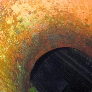

  5. A
    Bricks Crumbling on Chimney Breast. - Pics included!
    Thanks Nige With reference to where the air bricks should go below the lead sheet, I have a photo that shows a view inside the chimney before one of the pot caps was put on last year. One of the pots had been left without a cover. This photo was taken by the bloke who fitted the pot cover...
  6. 14. Looking inside pot

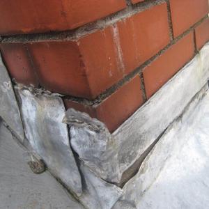

  7. A
    Cheers alittlerespect, excellent info. That all sounds like a good idea. I've uploaded a few more pics including a view of the pots. The first ones show the old inboard flashing which was renewed last year. The old flashing looks like it was just glued on with silicone. The new flashing is...

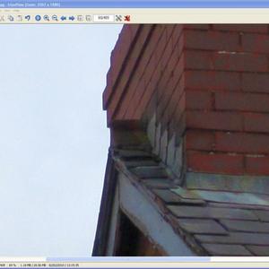

  8. 13.Current outboard flashing at front- not renewed
  9. 12. Current outboard flashing at back- not renewed

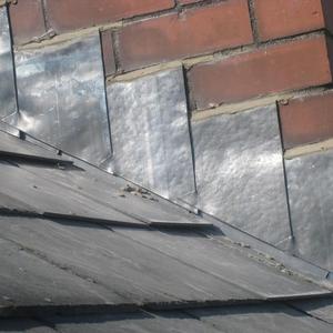

  10. 11. New inboard flashing
  11. 10. Close up of new inboard flashing

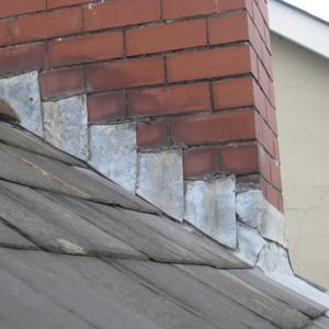

  12. 8. close up of old flashing- now replaced
  13. 9. Old flashing and Pots
  14. 7. Old flashing that has now been replaced

    John Fair point about the outboard flashing. No scaffold was used for the flashing repair on the rest of the chimney so it's possible it's not great. If this flashing was poor, would the dampness make it round to the mortar joints I have exposed in the loft? The raised ridge tile was part...

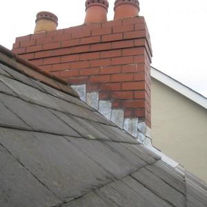

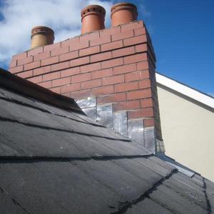

    Thanks John I think the flaunching was supposed to have been renewed but the pots were not removed so it was likely a patch job. I've got a photo of the set up of the lead on the chimney stack Hopefully this is clear enough. It's pretty much the same from the front view Cheers, Andy
  18. 6. Chimney
    6. Chimney

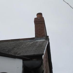

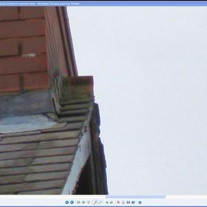

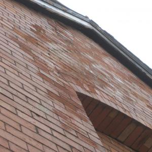

  19. A
    Hi Everyone 2nd post on here! This has proved to be quite a saga so hopefully the experienced posters here can help me out :) I’ve got some crumbling bricks on my chimney breast. It has been getting worse over the last 6 or so years. I have had various people look at it but nobody is sure...
  20. 5. Gable
    5. Gable
