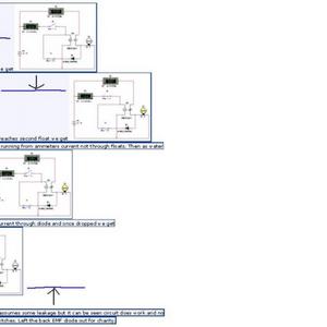

    I have set up and tested the above schematic Using a domestic car charger as the power source The sequence has work and it has not blown the float switch but I could only get the chargers to show a maximum of 2 amps and I wanted to put a heaver load through it just to test it properly relay...

    Ericman I have looked at your diagram again and swapped the switches round in the diagram The sequence now works If you are so sure that the current wont blow the switches then I think I will make a circuit up on my desk But before I do I need to know what some of the items are in the...

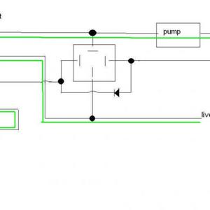

    quote="Spark123";p="1140108"][ No, the current cannot flow in the direction you have indicated on the diagram as the diode prevents this. If you missed the diode out of the wiring then yes, you could overload the switch. As I have said on a number of occasions now, you need to fit the diodes...

    NO! How can you have ‘water on its way up’ if the pump/light is switched off This is a ‘pump in pump’ not a ‘pump out pump’ you know What’s the K in the diagram and what are the U1 and U2

    spark123 I've re drawn your schematic Im worried about the load from the pump on to port 87 and there being a positive from live on to port 30 and then onto the float switches Surly one of them is going to be overloaded Just wondered why you drew your diagram so the switches wear the other...
