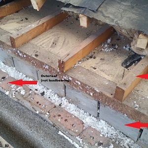

    Hi everyone, Hope you are all having a nice Bank Holiday. I am in the process of doing a hip-to-gable conversion and my builder is starting the actual gable end wall for me soon (this week). I have come to a bit if a dilemma, I have stripped back the tiles on the hip and cut the rafters ready...
  4. 20170416_185811-ceiling Joists
