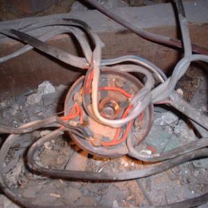

    Prince Phillip and Indian Electricians
    Do you remember when Prince Phillip (whilst touring a factory in Scotland) looked at a fuseboard and said 'Looks like it was wired by an Indian'! See the images below and his comment was probably made from his navy days when he sailed into Bombay! The thing that is striking is that this...
