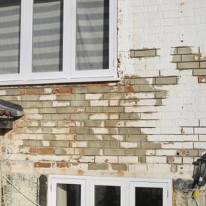

  10. RobinClay
    Flashing over a window
    We've had new windows fitted. Some of these - under modern concrete lintels - are flush with the outside face of the wall, or only slightly recessed. Other older windows under brick arches have a metal strip over the top to shed rain away. Should I do the same over the concrete...

  14. RobinClay
    Filling an external 20mm gap between window and brickwork
    O.K., so you've all had a good laugh But it's not reeeelly that funny :( Any suggestions as to the best way to fill those gaps ?
  15. RobinClay
    Gable window. Before:- __ Capped chimney in loft, over window Cladding removed:- Note short lintel - click on pic for enlarged version ________ LH end of Lintel _____________________________ RH end of Lintel After, showing gaps between window frame and structure:-...
