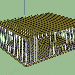

    Okay, Bodge it & scarper (great name btw), Foundations- I had come to the same conclusion- a raft foundation would be best for the reasons you point out. There are some trees near by - one about 3 metres away, in W London we sit on clay, not that stable, the original garage had to be knocked...

    Thanks Zac. I think I'll be going for a concrete slab with insulation in. I'll update when I know more. My concern is that it is a bit of a wet area with clay soil and trees not far away. I also have a concern for the rafters as they need to span 5.25 metres so I'll need very thick ones, maybe...

    Hi folks, Happy new year to you all! It's that time of year where thoughts turn to DIY projects for the coming year so for my first post on this forum I wanted to outline my plans for a self-built insulated garden room (all the rage at the moment I gather from the number of posts on here) and...
