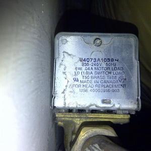

    Thanks Gasman Yes, there is a device that looks like this just beside the hot water cylinder - it's pretty awkwardly fitted, so cannot see the top - can only view the writing on one end of it: V4073A1038 230-240v-50mhz 6W .04A Motor Load 1.0 (1.0)A Switch Load T50 Brass Ts88 Made in...

    Hi to all I've got a problem that I think I've diagnosed, but not 100% sure. At the moment, our hot water / central heating systems cannot be turned off! They continue to operate at the hours set by the Potterton EP2002 timer controller that is in the airing cupboard with the hot water...
