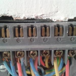

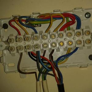

    Thinking of Wireless Room Thermostat
    My boiler is not starting up for the HW either. Starting to panic now, might have to uninstall.
  2. K
    Hi, I have fitted as your instructions but I think I have a problem. The wireless room stat seems to be working, it connects with the relay and switches it on and off when I turn the stat up and down but I can not get the heating to start up even when I turn Stat up to 30 degrees it still...
  3. K
    OK thanks, I think I have it now, I put a small wire in the Junction box to replace where I take the old stat from, linking terminals T4 and T5. Yes it is only a Temperature wireless Stat. What about placing the relay below the Boiler is that OK?
  4. K
    My other question is that the only sensible place for me to fit the relay is about 300mm below the Boiler. Do you think that will be OK? they say to fit to one side of boiler in instructions.
  5. K
    Thanks for the reply. When you say Link L and A in the relay box, I take it you are talking about L as being the Live that I have already connected to from the programmer? I just wanted to make such because the model relay I have has two L's. it has a block of 3 terminals together N,L and L...
  6. K
    Sorry to come back so late on this post but I have only just got the actual wireless thermostat to fit. I was going to buy one ages ago but I was promised a free one that a Friend didn't need any more and it has taken this long to receive it. The model of the Wireless stat I have now is...
