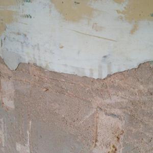

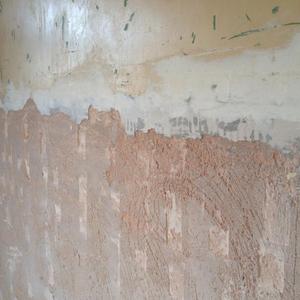

  2. L
    Will this take a skim
    This wall has been previously tiled half way up. The undercoat plaster is difficult to remove. What are my options.. Will it skim half way and blend in Leave the top skim on and reskim all of the wall All plaster off and start again Dot and dab Thanks Andy
