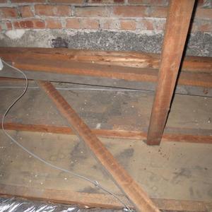

    the chunky beams under the perlins are resting on 3x2 timber verticle the lenth of the house and also walls are underneath most off the way along. i am laying chipboard behind the purlins screwed down to origanal beams this is the floor floating there is alot of stuff up there now which...

    the floor is floating and not resting on the joist and i am just making it for the kids to play up there out the way because theve got more toys then toys r us in the house. can you tell me where you would put them extra support beams if i remove the centre beams. take a look at the picture...

    THANKS FOR YOUR HELP STATIC VERY USEFUL. THE POST YOU SAID WHAT ARE UNDER THE PURLINS I don't THINK THEY ARE QUEEN POST BECAUSE THERE JUST NAILED TO ROOF BEAMS AND TO FLOOR JOIST AND I CAR'NT SEE NO STRONG WALL PLATE UNDER THEM. I AM THINKING OF LEAVING THE SMALL POST IN NOW AND ADDING...

    HOW COME YOUR TELLING ME TO GET A S.E BEFORE I CAUSE MORE DAMAGE WHEN THE BEAMS WHAT IVE REMOVED ARE ONLY TEMPS. ALLS I ASK WAS IT SAFE TO REMOVE THESE BEAMS IN MY PICTURES AND YOU COME BACK WITH THIS IN BIG RED LETTERS IN 3D WHEN YOU HAVE STATED A DIFFRENT ANWSER IN --EMMA WARRENS --REPLY...

    HI BIG ALL I HAVE PUT SOME PICTURES ON CAN YOU TAKE A LOOK AND SEE WHAT YOU THINK MATE. I THINK ITS THE STRUTS AND COLLARS I HAVE MARKED UP WHAT I WANT TO REMOVE

    MY FRIEND HAS THE SAME HOUSE AND REMOVED ALL THE SAME BEAMS I HAVE AND HE DONE IT SEVEN YEARS AGO AND ITS COMPLETELY SAFE FOR LOFT STORAGE. ITS JUST THE STRUTS AND COLLARS I NEED TO NOW ABOUT . THANKS FOR YOUR HELP MATE

    surely these struts and collars can be removed if i support it more . anyone else with help or ideas on this thanks
