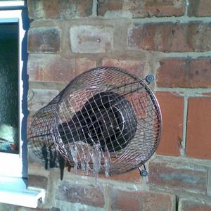

    Water Dripping Heavily From Boiler Flue
    No. It's a non-opening window. Boiler is fitted understairs. I posted the picture merely to demonstrate that condensing flues,even correctly installed ones, can appear to drip. Strictly speaking the icicles are not caused by dripping from the flue in this case but by the pluming passing...
    This flue has the maximum fall back to the boiler - and it appears to still drip.
