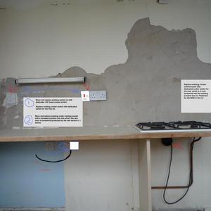

  2. Existing socket/switch layout
    Proposed changes to allow new electric oven and induction hob

    Ok so I could connect them both to the existing cooker outlet and leave the 32A MCB in place. This would be fine until all four rings and the oven were on at full whack where the MCB may well trip? Not ideal in my opinion, but essentially still safe is that what you're saying?

    Hi, first post, although have used the site from time to time for good advice so go easy on me! I'm refitting a kitchen that was fitted around 10-15 yrs ago. My consumer unit is a Crabtree box (with RCD) and the cooker circuit is on a 32 Amp MCB at the unit. This then leads to a Switched...
