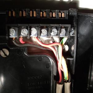

    Boiler not firing, no H/W or C/H
    Problem located. its the Sundial Y Diverter. I took the cover off and had a poke about with the actual mechanism and it appears like it has stuck. with a screwdriver placed on the actual mechanism i am able to give it a little flick and the biler and pump fire up. Is it possible to...

    The SL from room stat goes to the 10 way j/box. it is connected in the connector strip with the white cable from the sundial Y diverter.

    http://media.diynot.com/143000_142552_43890_86270850_thumb.jpg http://media.diynot.com/143000_142552_43891_44135989_thumb.jpg http://media.diynot.com/143000_142552_43892_33873073_thumb.jpg Ok. FCU to boiler on. Water and CH set to constant. At Boiler: 230v between ON and Live. 0v...

    There appears to be no power at the pump. I tested across live and neutral and it showed 0v

    The pump is not running. Normally when I turn the water and heating on together the pump starts up and the boiler fires up (you can hear their distinct noises) Neither the pump is starting and boiler firing.

    It's a Honeywell sundial Y diverter. There is 230v to the boiler mains. There is 0v to the room thermostat when the water / heating is off and 230v between live and switch live when the water and heating is turned on. How do I check the switch live at boiler? Everthing was working...
