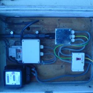

    Was put there temporarily.moved following day to where the metal adaptable is to house 2X100a henley blocks to join the 25mm SWA and the tails. At that stage was purely there to house thejunction between 2 2.5mm cables. Overkill, but its all he had at the time. Would you agree getting the lad...

    I doubt there is space for that now after 2 days work to relocate the CU, plus he is going to need another day for testing in the future, 600 quid total for what isincreasingly sounding like a botched job. Its been sightly modded since, but this is what it looked like after day 1: I...

    Will do cheers. Domestic installer with 5 years apprenticeship and 5 years in the trade. Will get some photos on my next visit, sounds like the easiest solution may be to get the DNO to get me connected up to local TNCS supply when they come round next; will solve most of the problems. Only...

    Sure. But the SWA is deeper than 50mm, so would have thought on top of the earthed mechanical protection, no RCD would be required? THe Switchfuse was placed to meet the DNO requirements for one due to the length of the meter tails.

    OK, so its less of an issue, other than I have a junction box connecting the 16mm submain and its max rating is 60A.... other issue I pointed out was I wanted the system to be easily upgradable to 100A, which I cant do now without the later addition of a 60A switchfuse, which is a massive pain...

    Thanks, its protected by a BS88 80A fuse, why does it need RCD protection as well? Disconnection times? Its currently protected by a switchfuse after the supply fuse, I would have thought that RCD on the 25mm SWA would have been overkill as the SWA is earthed too? As for the submain, I...

    I had the CU moved 3 metres and had all the wiring removed from the wall cavity... I have 25mm SWA bringing the supply up the cavity now, where its split in henley blocks, 25mm tails to the new CU and 16mm tails to a sub meter supplying the annexe. There is no Overcurrent protection on the 16mm...

    cheers. Just had some work done by a decent registered chap, reccommended, who hasnt applied overcurrent protection to the submain before the submeter and has used a type B, rather than type S RCD.... :roll: 16mm is in trunking until it goes beneath the floors
