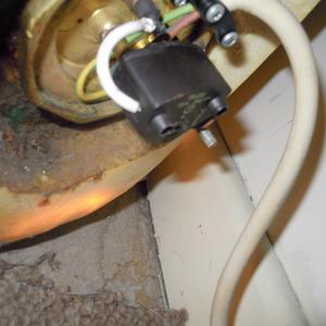

  2. S
    Immersion heater timer
    Thanks for the advice. The heater is working fine. I changed the thermostat, by buying the same sized one from Screwfix. The only wires I touched were the brown and white ones, which I guessed were at the same sides as before. That is what I was unsure about. All electrics in the flat were...

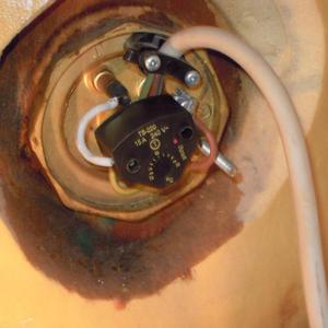

  6. S
    Hi An update to this is that the water was boiling hot, and using lots of units. I have now replaced the thermostat. There were no instructions, so I have rewired the new one the same as the last. See photo attached. Could anybody please confirm this is OK. Thanks.
