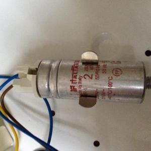

    Celling light bulb...
    I am in UK, not sure why my post has been moved
  6. M
    Could you point me which light bulb will work with this choke please. I can go back to screwfix and change it again. I am not expert and have no idea which light bulb should work here.

    See attached images: Few weeks back, my celling light stop working and I though it is light bulb or starter so I replaced both, but still it does not work: I used following light bulb: (Sylvania® Lynx QE 2D Compact Fluorescent Lamp 4-Pin 2850Lm 38W)...

    My ceiling light stopped working few weeks ago. I lost the old tube light which comes with ceiling light. Below are the description of choke on this ceiling light? EC 36 LC502K 240V 50HZ Can you please advice which light bulb could I use with this bulb?

    Wiring seems ok to me. I will ensure starter is of right size. You mentioned I need 36W starter. Also do you think my tube is of right size if compare with choke description I provided? Any idea how much will it cost for the fitting ? Any recommended place etc to buy fitting...

    Green bit is the starter. I will check if it right size. The new tupe is 4p. I think tube has 4 pins I will check pins when I will get home.

    I have already tried a different starter? Do you think Im using right bulb? Here is what I can read on the tube: 38W/835/4P Here is what on the choke: EC 36 LC502K 240V 50HZ

    I attached pictures of my ceiling light. All of sudden it stopped working. I though it might be just bulb/tube and replaced it but still does not work. All other appliances in the same room are working fine. I have no idea how to figure out what is wrong. Here is what I can read on...
