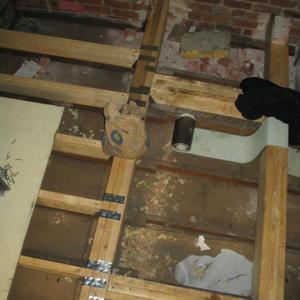

    fitting usbs in a hipped roof
    this is veiw of the stairwell triple trimmer joist area,its very small as we are using the paddle stairs which Iv been told are more 61o than 41o ? these should arrive tommorow,loads of fun then

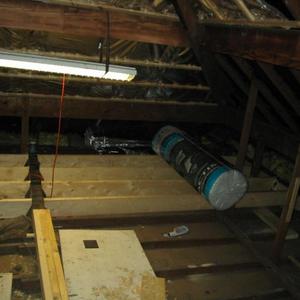

  3. M
    this is the bolted and welded join between two steels the same amount of bolts are also on the vertical plates across both beams.

  12. M
    Hi,dont know if anyones reading this....! I have now got the steels fitted ,they were put in place in sections ( each beam in two) bolted together with about six through the side and another six at the top,through a plate spaning both beams ,this plate has then been welded to the main beams...

  15. M
    they have now sent me additional info wriiten in pen saying -: beams to be spliced together with 8 x m12 bolts. 2 web plates & 2 flangeplates and fillet weld all round in situ. I phoned thanked them for the info and then I asked about chamfering the beams and the designer said hes been...

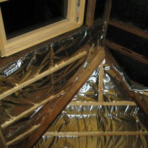

  20. M
