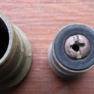

    They've cost about 25 quid a time. (100 quid when the plumbers have fitted them.) I've thrown 5 away. Have got 3 left. I'll have to see if I can get some new washers for them. Thanks for the idea. Can't see any grid or dirt or degradation. I'll try a 6 inch copper float. Thanks to all!!!

    I've done both at different times. Change the float and reused an old float. At the moment I have a choice of 2 floats, but they both perform in the same way... they don't close off the valve completely.

    Thanks for the 2 replies above. The thing I keep replacing LOOKS like this (might not be exactly the same): The water level looks like it should stop about 4 or 5 inches below the level of the overflow ... but it doesn't stop filling up ... as the ball rises, the flow rate does slow...

  18. M
    Overflow in main water tank
    Hi I live in the UK (if that matters!) and have a problem with the water tank in the loft: it keeps overflowing. I have fitted 4 new brass equilibrium ball valves in the past year. For a month or so they seem to work okay (shutting off the water as the water/ball float rises), but after...
