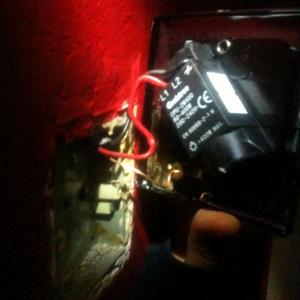

    your miss understanding me bas, i can't make out head nor tail of why i have a problem. the diagrams are simple, i have a one way circuit on this but i don't understand what the problem is that i don't have power to the light when theres no problem on the consumer unit and no other fuses in the...

    ok i've put both the wires together and nothing. I seem to have lost the power now (red wire) to the switch. I've also tried a new switch and still nothing. again nothing has tripped on the consumer unit. this is all very strange as all the other lights work in the house. please help !

    yea red had the power. just going out now to get a strip....bit worried about putting the red and black together but if that's ok will do.

    on the bottom picture of the switch, is it normal to only have one red/black/earth cable?
  7. D
    living room light problem ! Plz Help !!
    theres a couple of pics in my photos!
  8. Untitled
    1xred 1xblack 1x earth
  9. Untitled
    there is the same wire coming out of the ceiling as at the switch

    Sorry posted before i saw your reply fella. Sorry i'm looking at the Schematic diagram thinking that 5amp thing is a fuse. so it's probably the switch?!

    yes i've got power at the switch but no power at the ceiling connection...will there be a fuse in the wiring!?

    ok i managed to get hold of a voltage tester, and i have power at the socket but not at the ceiling. looking at the diagrams am i right in saying their will be a fuse pushed inside my ceiling? cheers

    hi wdta i don't know, however, the wiring in the light switch matches the ceiling wiring, so doesn't look like it!?

    I seemed to have developed a problem that has me stumbed, i hope some one can point me in the right direction !! My living room light has recently gone, i believe due to my wife putting 60W bulbs into a "40w maximum" light fitting. one night the fitting went ping and the light went out...
