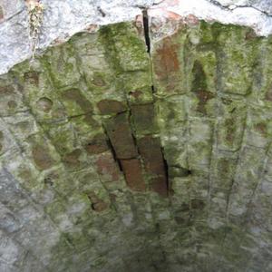

    Hi as promised here are some photos showing the kiln that I am trying to repair. View of top of kiln entrance Area where rotten bricks cut away Top Side Other Side Entrance to kiln Inside roof showing crack and where pointing needed, I am hoping that the...

    Roof Showing Crack and where pointing is needed

    Pointing old brick arch kiln entrance - Now with Photos
    Hi Stuart, thanks for the advice on the render. If I understand correctly the scratch coat is the first coat and this is then followed by the top coat? I had another look at the pointing needed in the ceiling this morning and as you suggest I think I can do it by pushing the mortar in at an...
    I have an old underground brick kiln in my garden and it has a arched tunnel entrance, the arch is in poor condition and I am doing some work to repair it. The arch is made from soft red brick and lime mortar, on the outsides the outer layer of the 2 layers of bricks that make up the arch was...
