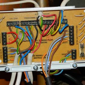

    Here are two views of the JB - the second one shows the wires coming in a bit better. Any views, anyone? Do my connections to the HW and CH terminals look correct? [img]

  7. Junction box
    Junction box
    Honeywell junction box for heating/hw 10/04/2012

    Right, I'll get a photo organised and post it. Some might say my 'purple' is blue but it's a very purplish-blue. Surely not an earth - even an amateur like me can recognise the green-and-yellow. The junction box is a Honeywell, white plastic rectangular (horizontal orientation) about 6 inches...

    Thanks for the reassurance Spacecat. I've now tried swapping the HW actuator with a spare one and still no orange light - so I'm thinking maybe I made a mistake when noting down how to wire in the new actuator. My notes say the wires should go into the junction box as follows (moving down in...
