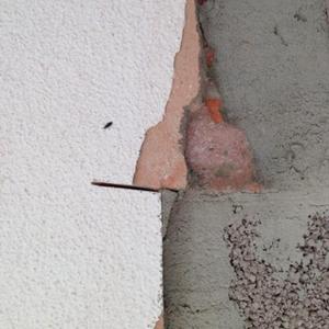

    Joining new render to existing render

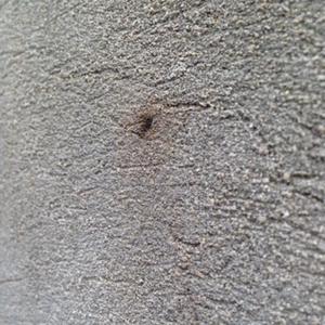

    Right ... now a new drama: My nice, crisp newly rendered walls (straight off fresh blockwork) suddenly look (five days after completed) like they've been subject to a massacre. Loads of weeping red/black spots everywhere. Render mix was cement, lime & plasterer's sand (1:1:6). Now only...

    Close up of spot ...

    Thing progressing ... my guys have notched out (? not sure right terminology!) parts of the existing render so that no long straight joins between new & old. And a lot of the new areas have been rendered too, so that coming on well. Question regarding paint removal before the 5mm mesh layer...
