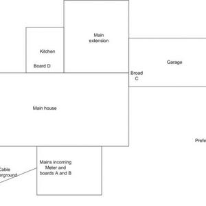

    Other points I need to consider are generator location. prefered location is marked on plan below. It is good in that I can build a small lean,to against the end of the garage to keep the genny secure locked away and further add to its sound proofing, I would also extend the lean-to...

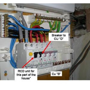

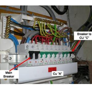

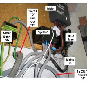

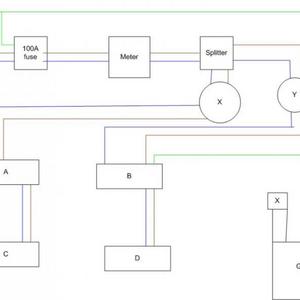

    All Please find attached a VERYbasic layout drawing of my house circuits and some photo's The house was fully brought up to standards 3 years ago, requiring some rewiring of the original house section (old rubber wire), new CU’s with RCD’s and trip breakers rather than the original...

    Thanks very much Eric, I will have to read and probably re-read and then get back to you with a few questions. But one straight away, are you stating that although I only have 16A 240v sockets, because there are 2, by feeding both in gives 32A? Or am I just looking at it to simplisticly...

    But does not this set-up allow the genny to be turned on and feed power into the grid and vise versa? i.e there is no break before make switch? Coming back to the Human factor? Apart from that I see what you are saying.

    Yes I do know that bit, Tescos have not quite taken over everything, LOL Thanks all it has made things clear (?) Need 100- 125 Amp switch 3 pole (break before make, with off position) Need best price/make Need dedicated earth with RCD in Isolate key ciccuits, lights, bolier and...
