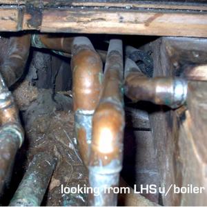

  3. Untitled

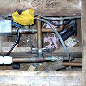

    Looking to the left of the boiler under the floor. Red dots correspond (see previous pics)

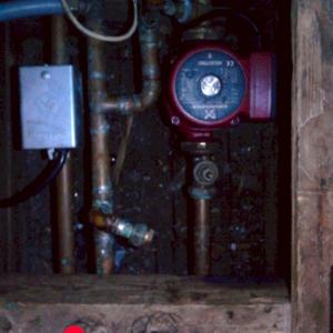

  4. Pump2010
    Pump2010
    Pump installed Jan 2010, again wrongly by Homeserve, but we have access to electrics. Arrow shows boiler pumping direction

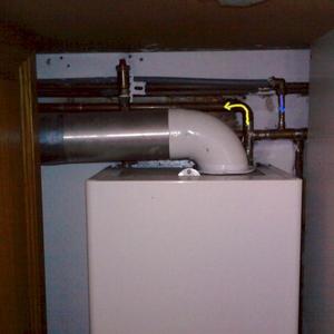

  5. Untitled
    Shows HW valve and joist at LHS of above

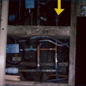

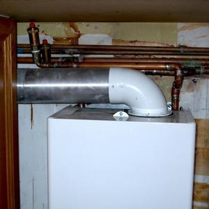

  6. Boiler
    Boiler
    Showing revised pipework Nov 2004. Pipework to underfloor for ch shown by red arrow

    I assume so. looking at the original plan of the pipework by the installers in 2004. The water comes out of the top of the boiler turns to the right behind a cupboard and down under the floor. http://www.diynot.com/network/WillsNana/albums/ All pictures I have are now uploaded (click on Pump...

    Underfloor pipework looking towards LHS of boiler

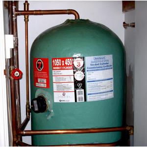

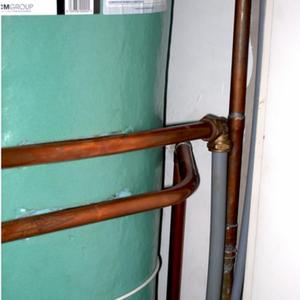

  16. Installed 2004
    Installed 2004
    Piping to cylinder showing copper o/f and plastic refill from o/f tank
  17. Installed 2004
    Installed 2004
    Airing cupboard
