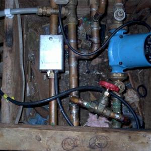

    Can a central heating pump be too big for the system?
    Can a central heating pump be too big for the system and what are the consequences? Our system was fitted with a Grundfos 15-60 130 cat no. 1/44/215 which replaced a Terrier TC6 TF110 IP44 Class H . The engineer said it was a bigger pump and we had to turn it down to level 1 as it was pumping...

    I've added a pic of the old pump, which the engineer said was too steep.

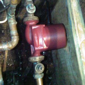

    I'm sorry as I don't know where the spindle is, but I have added a photo of the old pump, as it doesn't seem to look the same to me. http://www.diynot.com/network/WillsNana/albums/ Also, should the pump electrics lie under the pump?. And the new pump is a Grundfos 15-60 130 cat no...
  7. Showing old pump
    Showing old pump
    Underfloor pipework was changed slightly but using same pump which expired early Dec 2009

    I've added a bigger picture, I don't know where the arrow is I'm afraid. I wondered is why the pump is on it's side. Is that OK?
  12. Untitled
    Pump installed December 2009

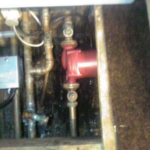

    Should the pump be fitted like this? The system engineer left us with the pump running on 3, then the water started bubbling in the overflow /refill tank. Not sure how include images with my post but this is how the pump looks...looking down into underfloor...
  14. WillsNana
    Micron70FF
    Not sure how include images with my post but this is how the pump looks...looking into the floor http://www.diynot.com/network/WillsNana/albums/ I'm sure that the old one had the circular bit facing upwards, as you have to put your hand underneath to get at the three levels (1,2,3), so is...
  15. Untitled
  16. Untitled

    They have been and installed the pump, but I notice the water pipe to the overflow seems hot. If the pump had been installed the wrong way round, would it cause the pipe to do that or has the cold just raddled my mind? Or could it be air in the system getting out?
  19. WillsNana
    Micron70FF
    No they may come back today, or it may be tomorrow :?
  20. WillsNana
    Micron70FF
    You were right SS. It's the pump.
