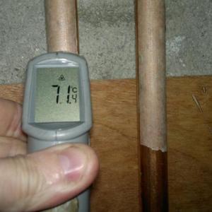

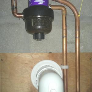

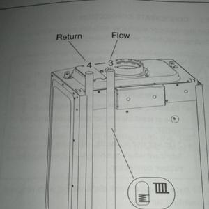

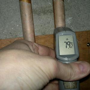

    The plumber has just come around to have a look, argued with me a bit then eventually agreed with me it is wrong and is sending someone around today to correct it. Thanks for all the help.

    Ok, I had to bite the bullet and purchase a brand new Greenstar 24Ri boiler! The thing is, I think the installer has got the plumbing connections wrong. Perhaps someone could confirm please? Looking at the boiler from the front, the return pipe, where he fitted the Magnaclean, is on the left...

    I wasn't there but he told my wife that the Worcester Bosch accredited plumber should have never hung it on the wall!
