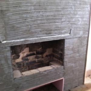

    Dear all I would really appreciate some advice on plastering my chimney breast. I am fitting a built in cassette wood burning stove but my chimney is too shallow so I need to pack out 25mm on the front of the chimney breast. I am intending to use a sand cement and lime mix of the ratio...

    Infact change of plan I'm going to attempt rendering it myself. Going to screw strips of mdf to both sides of the breast so they petrude 22mm then render up to these. That way it I can't get it wrong as I can rest a level on the two strips of wood and run it up the chimney breast to scrape of...

    Thanks again there is a lot of info there! I think I have to bight the bullet and put a 25mm 'something' on the front of the chimney breast to get the required depth Annoyingly, from reading the other posts, I have discovered that even gypsum fireboard is not sufficient as it is just...

    Thanks RedHerring2. Sorry I forgot to say that this stove is an inset stove, so it has a flange around the edge that is designed to be fixed to the edge of the opening. Ive included a picture so will hopefully make sense. The builders opening that is required (according to manual) is...
  11. opening
    opening
    The opening that I have created so far. Obviously need to build up the bottom (going to incorporate a log store also)
  12. frame
    frame
    steel frame just placed in position
