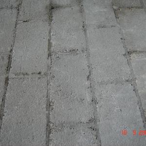

    Hi Roughcaster The PVA that I sourced for the roughcaster is Exterior Grade - Waterproof PVA from Unibond. I take it that once this dries it can not come back to life when wetted ? I have uploaded a picture of one section of the wall which was stripped back. You can see the blocks are...

    Hi Roughcaster I followed are earlier posting of yours and sourced Unibond PVA - Exterior Grade - waterproof version. Screwfix stock it. I am keen to have the stipple coating, but the new harler seems a little reluctant to apply it ? What will happen by applying diluated PVA to the...

    Hi Roughcaster Sorry to bother you with this one. Had all the wet harling chipped off the house - came off clean pretty much everywhere - there was no apparaent bond between the scratch coat and the standard dense concrete blocks. New roughcaster is going to PVA the walls first to seal...
