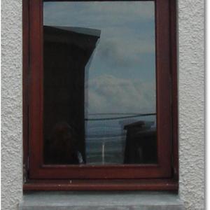

    How do I remove wet harling stains from concrete window sill
    Hi Roughcaster I have added a zoomed in photo of the sill which shows the white staining.

  15. S
    Hi Roughcaster Cheers for your reply. I have uploaded a picture of one of the pre cast concrete sills. Please ignore the roughcast - it is currently lying in a heap awaiting disposal ! All the sills have this white cement staining on them on the front face and also underneath...

  18. S
    Hi Can any one advise on how best to remove wet harling stains from pre cast concrete window sills ? The top coat of the wet harling used while ordinary portland cement. I thought about using brick acid, but am worried that it will attack the cement in the pre cast concrete sill and...
