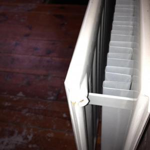

    is it defo a myson?????
  2. J
    Radiator bleed nipple/screw
    Just checked tonight and that whole nut does loosen off so I have been able to bleed it from that. Still should replace the whole nut with bleed valve. Have measured it and its approx 11mm. Do you think I'll get one??
  3. J
    So that whole nut will actually come off?? That's great if it does Cheers jacka
