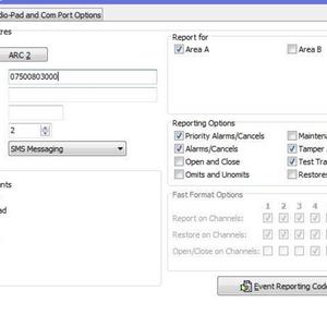

    Texecom Elite 24 Com2400 SMS issue
    All sorted thanks to secureiam. Even though there was nothing connected at the other end, I had wired up T1, R1 and earth. I pulled these out and the texts are now working! A big thanks to everyone who responded.
  14. M
    Correct, SMS connecting is the stage it seems to stop at. I can try and write down each stage it shows on the panel if its any help? My last idea is to change out the module for another one, apart from that, I am out of ideas.
  15. M
    R goes to pin 2 and T goes to pin 5 on the output of the master socket.
  16. M
    Yup, R & T. It was set to 0, I tried 2, thats a no go and 7 was the same. I just dialed the number from the landline and I get a modem noise on the other end.
  17. M
    Also, the box was sealed and it says com 2400 on the box.
  18. M
    Thanks for the details warning but I already changed my number before I captured the screen. Broadband via cable yes. It is wired to the secondary output on the master socket. If I dial my home phone twice, the modem kicks in and I hear beeping etc. I will try and call the vodafone number from...
