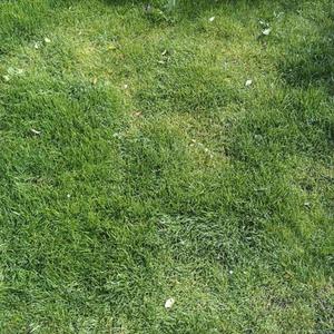

  6. C
    Raised Patio
    Im looking to build a raised patio using oak sleepers along the front. I planned on laying a concrete foundation then laying the sleepers on top with a layer of pea gravel between to stop them laying in any water that might build up, and also help with drainage. Can anyone see any problems...
