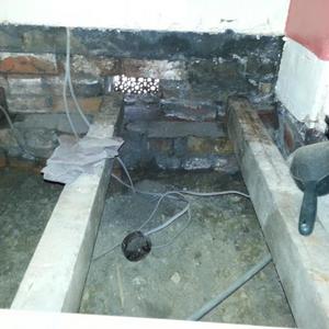

    floating floor joist advice/ventilation issues
    Dann09, You've got me worried. It's not that serious, this floor is above the cellar. Half of the cellar is accessible for storage,the other half is separated by a bearer wall and has been filled with rubble etc. There is ventilation but because there was so much stuff dumped that I believe...
    tony1851 great minds.....
  8. Y
    Pinenot The joists do not seem discoloured, there isn't an unusual smell and there aren't any pipes really close by. The water pipe is about 6ft away and I have that exposed and have not noticed any leaks. Could the fact that the joist ends were covered in soil and rubble encouraged the rot...
  9. Y
    pinenot I'll investigate the pipe. Your guess is correct regarding the solun. What are your thoughts on marrying 2 metre timber to the old joists? I just want to be sure what I am going to do is safe. Thanks for reading
  10. Y
    Thanks pinenot, those pics aren't very good, these should be better Where the old joists have rotted could I put a few arirbricks in there thus allowing ventilation and also stopping the kitchen floor material from moving? There are no external walls, they are all internal ones. Thanks
  11. Y
    I hope the following images help
  12. Y
    Thanks pinenot. Would pics be better?
  13. Y
    Hello, First time on here and hope that I can get some advice from the experienced. The ground floor living room has a cellar underneath, a bearer wall separates the the cellar storage area from the other half which has been filled with rubble and soil. I have now found the ends of three...
