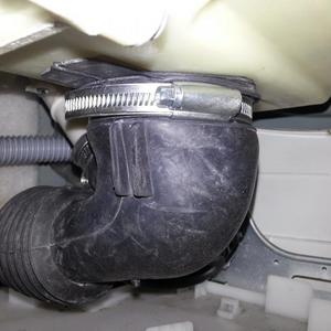

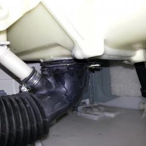

  12. I
    LG washer/dryer leaking
    Thanks for the advise, I would have never discovered the leak without watching and filming it while on spin. The price of the fix ? = £2 I've noticed as well it dries the clothes 10 times better on spin. I think this is because the pump was losing suction/drag due to the leak and air getting...
  13. I
    problem solved !! Turned out to be the original screw wire clamp around the top of the hose that just wouldn't seal the hose no matter how tight I screwed it up. I replaced it with a 70mm-90mm jubilee clip from b&q made sure I got it snug and the rubber hose right up to the top and...

  18. I
    Spooky that , because I have just done that. I filmed and took pictures while it was spinning from the back going inside and underneath and it is leaking from the main drum. Were the 2 halfs of the plastic drum meet there are 2 bolts this is were water starts gushing out. The water then must...
  19. I
    I'm at a loss as to why and were the water is coming from. It flooded the kitchen when on spin. It seems to do it when the washer is say over 1/2 full. So far I have ;- Checked all internal hoses & drain hose, dispenser hose (under stray) main bellows drain hose (under tub) and replaced most...
