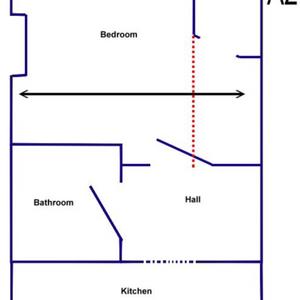

  2. J

    neither, theres a floor above, however its a conversion, so there floor joists are 2 feet above my ceiling joists, so theres a cavity above the whole of my flat. so if they wont span that far, do i need to make a building control notice, and what type of timber can i use as a lintle? And can...

    Yes about 6 beams run over the wall thats why im wondering if i need a supporting beam, and if its ok to use a timber beam, and what kind i need, :) Thanks

    No its a stud wall, however with the ceiling joists being only 2" x 5" im not sure if they can span 3.7 meters, I dont have much money so would rather avoid a SE, and just have some information from expereience so i know if and what i need to do BCO wise, Also no, I have a front door, thats just...
