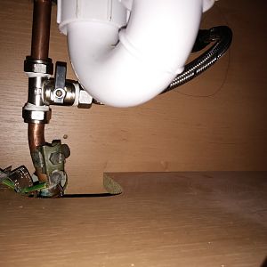

    Fitted Outside Tap now Toilet is Noisy grrrrrrrr
    Cheers Burnerman, will check that out too but If I can't figure it out I'll just keep the outside tap off until I need to use it. I'd love to solve it properly though, nagging away at us!
  13. rvp
    Agreed on the Ptfe tape but that's me being over cautious on leaks! I shall look into getting rid of the flexible pipe to the Outside tap. I don't see that fixing it to be honest but I shall try anything!
  14. rvp

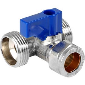

    Thanks all for the replies much appreciated. Here is a pic of what I've fitted, prior to this I had no toilet noise so it's 100% to do with this. valve by rvp posted 2 May 2016 at 8:36 PM I have tried adjusting the shut off valve but only closing it fully does it stop the noise. If I run a...
    Thanks for the reply. I fitted a isolation tee valve which basically is a stop tap and when I shut this off the toilet is fine. It's only If I leave this open that I have issues.

  20. rvp
    Hoping someone can help us here. I have just fitted an outside tap, no problems there teeing off the cold water feed under the sink downstairs works ok however the toilet now makes an awful racket when flushed/filling back up :( I had no issues before installing the tap, any ideas? just to...
