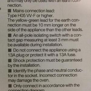

    Confirmed by Bosch. I can use the plug that comes standard, or if simply remove the plug/cable and I am able to hardwire it. Confusing much!

    Well the conundrum continues. I went and did just that, read the instructions. The instructions clearly say: Do not connect the appliance with a 13a fuse?? Wtf Bosch. Its got a 13a plug and cable...

    Upon further reading, I have found that the fuse in the plug is only to protect the cable not the device. The appliance does allow me the ability to unscrew the entire cable and plug. Thereby allowing me to connect the existing 6mm2 t&e direct to the new oven. Does that sound right?
