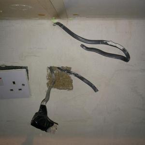

    New FCU's.
    That's what I thought. I was going to keep it 2.5 but someone suggested I maintain the flex size onto the spur. I guess is doesn't hurt to have larger. Safe as houses?

    New FCU's.
    sorry, my bad. typing in a rush. I meant cooker hood cable, not the cooker! :) The plate will be positioned behind the fake chimney and in line with the cable as it stands. Thanks very much for your time and help. Much appreciated.

    New FCU's.
    It is within, 110mm to be precise. I have a feeling you're going to tell me to move it higher! At the end will be a flex outlet plate for the cooker cable to connect, but I'm not 100% certain if it requires another fuse?. If I have a 3a fused dp switch near the cooker switch, that should be...

    New FCU's.
    I don't think I'll risk the self signing! I'll take your advice and leave the chase open for inspection Attached are two images, one showing the safe zone chase for the cooker hood , and the other the opening where the 13a FCU will be spurred along with the lighting cable (fished up to...

  8. B
    New FCU's.
    I have simply fished the cables in the 'safe zones' but upon further reading I think I'll need to bury then correctly. Can you point me in the direction on the best method for bury cables into dry wall? As for the RCD, yes, the circuit already has them. The zones I was referring to was...

    New FCU's.
    Hi all, Before I go and start tiling, and before I call a part P certified electrician to sign off my work. I would like to get your opinion please. I have added 3 spurs in the kitchen off existing sockets. 1. I have a 30a cooker circuit with 6mm2 flex onto a cooker switch and socket...

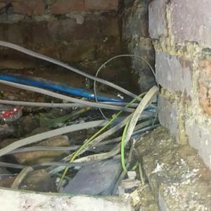

    No stop cock, plastic water mains, earth bonding?
    Thanks all for the replies, very useful indeed.
  11. B
    Hi there, you're correct. There was another pipe just to the left of that pipe that I marked as mains. I believe the blue pipe in the image below is the mains. And that is definitely plastic. Also on a side note, I've just realised that in the picture above the earth bond which I thought...

  13. B
    Hi all, Had an electrician come do a certification on our house. Not that I don't trust his judgement but I always like to get a second opinion. He says that we need to earth bond our water mains at the stop cock, however, we do not have a stop cock and the water mains that comes in under...
