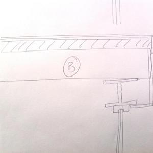

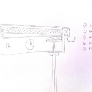

  5. J
    warm flat roof details
    hi, I am rebuilding the rear extension on my Victorian terrace, and would like some advice on dealing with cold bridging and detailing where the roof meets the back wall (which will have 3m wide folding doors in it.) Apologies for the drawings, I suddenly got obsessed with this on a...
