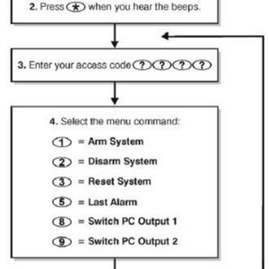

    Found this, maybe what your after. Looking like a bit of a tech freak it maybe bit basic for you. :P
