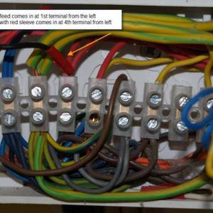

  1. C

  2. C

  3. C

  4. C
    Pipestat wiring - Honeywell 4360 F/stat to H/well 641B 1004
    Reading from the left I have 2 browns going into 7 & 9 but visually it is not possible to confirm which is the CH or HW. However the terminal on 9 becomes live when I trip the f/stat and the CH valve opens while T7 remains dead. Hope this helps. I also have a brown wire looping bottom T1 to top...
  5. C
    Thanks for your reply. The wires feed back to a terminal box and I have uploaded a picture to an album called (what else?) terminal box. The permanent live from the f/stat on T1 comes in at first terminal from the left and the switchable live (thanks for that clarification) comes in at 4th from...
