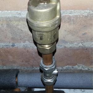

    auto air vent valve leaking in the loft
    The black screw on top was pretty much turned all the way to the right, does that sound correct as a setting? I basically replaced like with like buying an auto air vent from screwfix for a fiver. Fitted it no problem and doesn't seem to be leaking (famous last words). This time the screw is...
    I have just been up and turned off the valve. I also took a picture and dried everything off, just to see if water appears anywhere else. You can see on the top of the valve a wet patch, so water appears to be coming from the very top. I wonder if this has been leaking for a while.
    Morning, I have just woken up to water coming through my daughters ceiling, which is always a pleasure! So, I have been up in the loft, half asleep, and I think I have traced the problem to an auto air vent valve which I am presuming is on the heating system (which is off) which is leaking...
