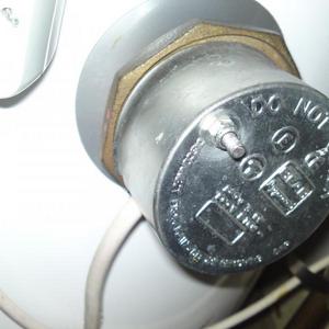

    Hot Water Cylinder Leak
  2. M
    Any ideas?

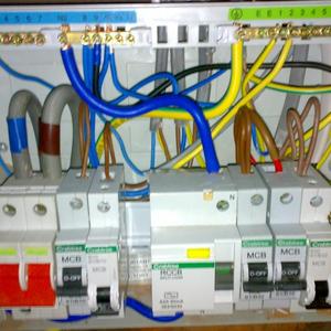

  3. M

    I didn't install the CU, just the 3 MCBS. My guess would be so that the lights don't go off in the area where the fault is. And those test results are non-existant.

    How's my CU looking?

  5. M

    Thanks for all the comments. I've still got to neaten up the new cables going into the CU with some trunking as they're only clipped roughly at the moment to prevent movement. So when I go to the wholesalers, I'll ask about the RCBOs(I'd have them for the ring finals and put all the lighting...
    The gas/water are bonded from another CU, so that's ok, right? The lighting ccts do not comply with 522.6.6 so should I put them on the RCD side? The old colours was because the shop had run out of the new colours but told me it would be fine if I sleeved them with the new colours. Is...
    I fitted the B10, the B16 and the B32. Does it look acceptable to you? Don't mention part P thanks :wink:
