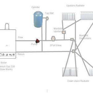

    Hello All, more pictures of Boiler, Pump, motorised valve and Hot water cylinder. Please advise what will be the best option for me to upgrade. https://plus.google.com/photos/111908875801852720812/albums/5967720439570449489

    I have Scottish gas 330 boiler(Glow Warm) which is currently controlled by Potterton EP2002 programmer. I believe Gravity fed hot water and fully pumped central heating system with grundfos pump and Honeywell 2 port valve which is connected 28mm pipe 8 mm pipes going to radiators. I am looking...

  15. Boiler 330 + EP2002
    Boiler 330 + EP2002
    Wiring diagram of the system
